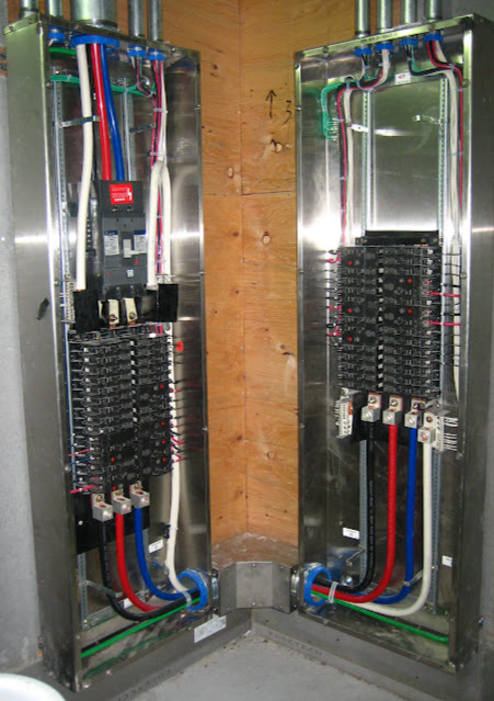

Ok had a little discussion with a guy here at work about what is required material wise($$) when terminating branch circuits in a panel. He said you need markers, linen tags etc. I know it probably spec/NEC driven but does anyone have pictures of the interior of a terminated panel...showing the shaping pf wires, terminations etc. Thanks.

Here's a 400 amp, 2 section, feed-through panel. Just need some wire ties, a number book and patience. ;)
infinity
New Jersey
Journeyman Electrician
Also don't use that panel as an example it looks like it violates 210.4(B)&(D).
Wouldn't that depend on when the panel was installed?
As far as I know there are no SP MWBC's in those panels. And for what it's worth the 2014 NEC will include a provision for using number tags on the conductors in lieu of a piece of tape around a MWBC.

Ok, isn't a MWBC two or more ungrounded conductors? So essentially a MWBC could not be on a single pole breaker

Yes it would matter when it was installed, but any time I see black and red and blue wires, I can usually be sure that theres a MWBC.

It's a little hard to tell from the photo but those blk/red combinations are on a two pole CB. Also this was installed under the 2005 NEC.

IDK maybe he pulled seperate neutrals. I commend you on your panel and wire bending skills. Most importantly on your extream patience. However, please take no offense to this, its not personal, but if you made a panel look like that while working for me you would be fired. Its like you took my money and through it right out the window to impress someone that knows nothing about electrical work. they just want everything pretty. I have heard the arguement a thousand times ( oh I can do that in the same amount you guys do a regular descent panel) and each and every time its BS. sorry.

Fortunately I work for people who expect nothing less than the work depicted in the photo. A skilled electrician can do a neat job almost as fast as a slob can do a sloppy job. In my world if your panels looked like a photo taken from a home inspectors forum you would get fired. You get what you pay for. :happyyes:

Yeah panel looks great, unless you're the maintenance guy that's got to go in there and cut off all of those stupid tie wraps. If you want the panle to look neat use solid wire.

If you've ever work facilities maintenance you learn very quickly that you use existing conduits when you can, you use existing circuits to pull with, you sometimes find a circuit simply by tugging on it, you have to move circuits around in panels for various reasons or you simply need to know which conduit something is coming out of.
When you use stranded wire, the only way to get it to look like those pics is to use tie wraps. If you pull solid wire you can still make it look like that and and you don't have to bundle the wires all together. I've also know that a lot of guys that bundle their wire like that, pick on the west coast guys for using only one two inch KO to bring in all of their home runs in resi panels.
