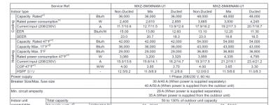

One data point: I looked at the Technical and Service Manual for Mitsubishi MXZ-SM??NAM-U1, where ?? is 36, 48, or 60 (3-5 tons). These outdoor units support 2-4 to 2-8 indoor units (depending on tonnage). The MCA in the manual is specified as:
29 A (When power is supplied separately)
35 A (When power is supplied from the outdoor unit)
Presumably that refers to power to the indoor units.
Cheers, Wayne
Cheers, Wayne

So does that settle it? Sounds like the outdoor MCA reflects the max number of indoor units?
I think so, for units listed to IEC 60335-2-40, assuming the excerpt above is accurate. I didn't find a way to read the standard free online from the source itself.
