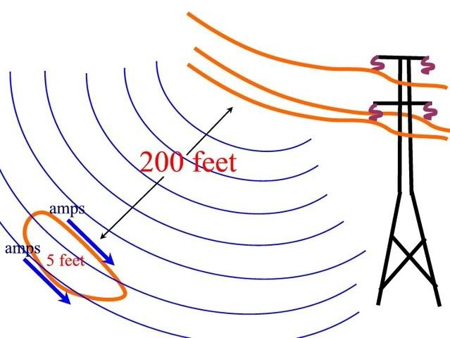

Here is a better diagram showing my point:
The point is, that opposite sides of the loop will try to make the current flow, for example in my diagram (arbitrarily), from left to right.
If we took two seperate conductors and spaced them 5 feet apart, certainly the voltage polarities would be in the same direction. If we simply connect the two ends together, the voltages in each side of the loop would oppose each other.
Now, the conductor which is 200 feet away would have a somewhat larger flux cutting it than the one which is 205 feet away. But would it be enough to make 1 or 2 amps flow?
I am still doubting this. Am I missing something?
(The diagram should probably say "volts" instead of amps.

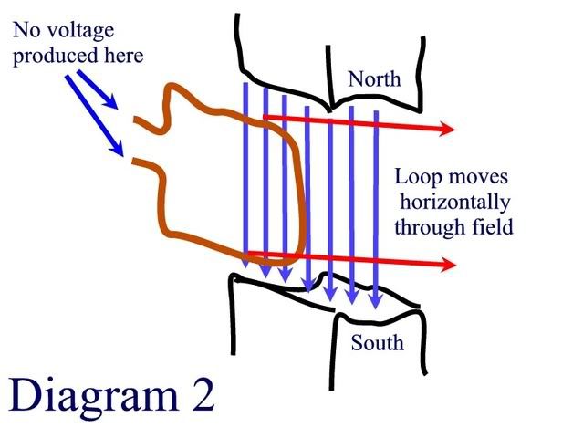

Diagram 2: Now, instead of rotating the loop, we simply move it horizontally through the field. The voltage polarities of the top and bottom are the same, and they cancel out, leaving no overall voltage on the loop. It does not matter whether the loop moves or the flux moves. The flux is cutting both wires in the same direction.
We can use the left hand rule for determining the polarity, but arbitrarily, say the top of the loop has negative to left, positive to right. The bottom of the loop will have the exact same polarity, negative to left, positive to right. And we are connecting the positive to the positive, which makes the two voltages cancel.
Diagram 3: Shows the power line flux cutting the top of the loop and the bottom of the loop, both in the same direction. The exact same scenario is set up as in diagram 2. No voltage produced. Well, the only voltage actually produced is that the top of the loop is closer to the magnetic field and will have a slightly stronger flux density than the bottom of the loop. Only this difference of flux density will produce a voltage in the loop.
Say the top of the loop is 100 milligauss. The bottom of the loop is 95 milligauss. Only 5 milligauss will produce voltage.
Now, if we were to rotate the loop, then maybe we can create some significant voltage.

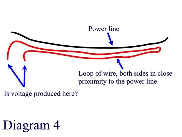

One more thought - Diagram 4
If both sides of the loop are in close proximity to the power line, no voltage is produced because the voltage in each loop is opposite of the other. Hopefully this will get the point across about my claim that the voltages on each side of the loop would cancel.
Or am I wrong?

I would have to say that you need to do the calculations for the top side of the loop and for the bottom side of the loop. Both sides of the loop create a voltage, and these voltages will subtract from each other, not add.
For example:
For the top of the loop, let 500 amps flow in wire 1 and have the distance be 200 feet. Calculate voltage
For the bottom of the loop, let 500 amps flow in wire 1, and have the distance be 205 feet. Calculate voltage
Now subtract these two voltages to get overall voltage of loop.
And, this is ignoring the fact that much of the magnetic field will be cancelled by the other phase conductors on the tower before they ever have influence on the loop.

Yes, and even without your additional drawings above, I agree with you. Even a wire loop between two HV conductors would have to rotate to develop any appreciable current.
It's aslo ignoring the fact that a closed loop (or one incorporating an ammeter) would be of such a low impedance that the open-circuit induced voltage would be eliminated.
