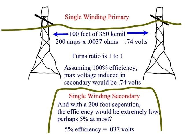

One more thing: What we have is a single winding primary with a single winding secondary. Turns ratio is one to one, meaning the voltage ratio is one to one (assuming a perfect transformer).
Consider 100 feet of transmission line of 350 kcmil wire which is inducing voltage into 100 feet of secondary wire. Resistance of 100 foot primary is .0037 ohms. Assume a load of 200 amps. Voltage on primary winding is .74 volts.
The most that could be induced in secondary is .74 volts.
Now, with the large distance between secondary and primary, it is nowhere near 100% efficient. Maybe closer to 5%. So the secondary voltage is .037 volts.
And this is assuming that none of the magnetic field of the primary wire is being cancelled by the other phase wires. If we take that into account, I would say the voltage in the secondary would be practically zero.
So I am again going on record with the opinion of bullcr@p. Perhaps those in the know can set me straight?

Crossman,
I like the way you are thinking, but I belive that you have made a few errors.
In post #37, you make a differentiate between flux lines 'cutting throug' conductors versus the net flux through the center of the loop. My understanding is that these two ways of looking at the issue are _equivalent_. The rate at which flux lines cut the conductors is equivalent to the rate change of net flux enclosed by the loop. So you can figure your voltage either way.
When you did your analysis of the voltage drop on the HV line versus the voltage drop in the coil, you suggested that the resistance drop in the primary limits the voltage that could be induced in the coil. This is not the case. Any current induced in the secondary would create a magnetic field which would result in a magnetic voltage drop on the primary. If the secondary were very well coupled to the primary, you would have a transformer and could induce lots of voltage in the secondary, at a cost of lots of voltage drop in the primary. You are correct in that with a 1:1 turns ratio the voltage on the primary is equal to the voltage on the secondary, but this is the magnetically induced voltage, and ignores any voltage drop.
I belive that your diagram expresses why the coupling between the transmission lines and a random five foot coupling will be very weak. There will only be a slight difference in the flux cut by one side of the coil versus the other side, which is another way of saying that the net flux flowing through the coil would be extremely small, and thus a very small voltage induced in the coil. The only reason that you get high currents in this case is that you have a low voltage applied to a dead short.
For the most part, if the transmission line is balanced, then the net current on all three conductors will be balanced, and most of the magnetic field canceled out. But there will be some net field, and for most line configurations, there will be a significant 'rotating field' component, just like in an electric motor. This rotating field could induce voltage in a coil somewhere in the vicinity. It won't be a strong field, but if you set things up properly you might get something.
I saw this in action at the Glen Canyon dam, while on a tour: power from the generators to the step up transformers was routed via conductors with perhaps 18" of separation. So you had three _large_ 'pipes' side by side carrying current from each set of generators to each set of transformers. At one point these pipes were vertical. Someone had placed an empty coffee can open side down on a spindle, between two of these pipes. The can was merrily spinning away, a very small mechanical load on a 'parasitic' induction motor.
Finally, a clamp on current sensor works with a primary that goes _through_ a magnetic core, but which is laying parallel to the secondary conductors. For some high frequency applications, two wires side by side going through the center of a ferrite bead is enough of a 1:1 transformer.
-Jon
Thanks for the complement, and there is no doubt I have been wrong before, and will be again!:grin:
I still think I am right on this one. Because of the geometry of the source of flux being outside of the loop, not having the source of the flux passing through the center of the loop, or not wound around a common core, the voltage produced in the top of the loop opposes the voltage in the bottom of the loop and subtracts, not adds.
See diagram: to me, the flux at the center has nothing to do with the voltage in the loop. Now, if the source of the magnetic field was inside the loop like a CT, then all the voltage is in the same direction and will add together. But in our case, each side of the loop will have voltages going from left to right(arbitrarily at a given time on the sine wave) and if we complete a loop by tieing each end together, the voltages subtract.
Diagram should say "volts" and not amps.
I agree with you completely now that you mention that. The induction from one conductor to the other will certainly cause the impedance of the "primary" to be higher, which will cause a larger voltage drop than just the resistance of the wire. Of course, any significant voltage drop would be felt on the power lines as a drop in voltage at the load end. Now, at 200 feet between the transmission lines and the loop leaves very poor magnetic coupling indeed.

On flux cutting versus flux in the center of the loop: the _total_ flux through the loop is not the issue; what is an issue is the rate change of flux through the loop. The rate change of enclosed flux is equal to the net flux that 'cuts' through the conductors per unit time.
You drew flux cutting a pair of parallel conductors that are quite close relative to the distance from the power lines. At any moment in time, the flux cutting one conductor will be very similar to the flux cutting the other conductor, and so the voltage induced in each conductor will be similar. That is what you drew, and what I understand. Because similar voltage is induced in each conductor, if you tied them together at one end and measured the voltage at the other end, you would get a very small voltage.
Whatever voltage that you did measure would be caused by the _difference_ in flux cutting the two conductors. This very small difference is the rate change in the net flux enclosed by the loop. Not the total enclosed flux, but the rate change of the enclosed flux. These are two different ways of looking at exactly the same thing. You are looking at the lines of flux that go past the conductor; but once they go past the conductor they are now inside the loop, or flux that starts inside the loop ends up on the outside. But the rate change of enclosed flux is exactly equal to the net rate of flux cutting past the conductors.
Absolutely the bulk of the rotating field will be nearer (and between) the conductors. Whatever was being measured was the net changing flux that managed to make it out of the near field.
