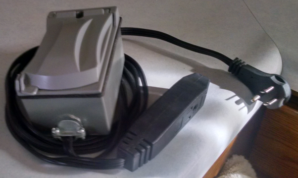

I have an ST01 installed in a bell box with a weatherproof spring-loaded flip-up cover cut into a 6ft. extension cord that comes in handy for timed applications. It can be done using a smart relay and similar assembly parts, but it's just more difficult and not as easy to operate.
I have an ST01 installed in a bell box...
