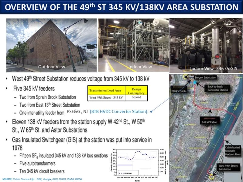

But inadvertently 49th st also cut power to 5 other 138kv cables supplying 50th and 42nd.
So at least 4 substations were de-energized as a result.
I was sent an oscillogram from a PQ meter at a client's data center in Pittsburgh that wanted me to evaluate a 5 cycle momentary undervoltage that they saw at ~7PM on Saturday. I don't have a 138kV transmission diagram of the Northeast, but I bet it was related. Their 23kV is derived from 138kV.
Here is the West 49st substation. It is a bulk substation.
It takes in Five 345kv feeders and steps down 345kv to 138kv via 5 auto-transformers.
It puts out 11 138kv feeders which supply 4 local substations.
5 138kv feeder cables supply west 65th and Astor, 5 138kv cables supply 50th and 42nd, and one 138kv cable is a tie (interconnect) to Vernon substation over in Queens.
