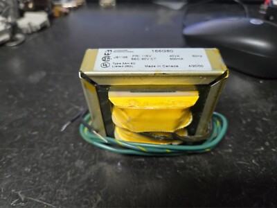

You could use one of these transformers with a rectifier cap:
Nice find the 80V + filter cap would rectify to ~113 VDC
