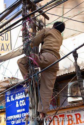

Sahib,
I appreciate your concern for our safety here in the US, but I think your efforts should be aimed at the activities in India.
