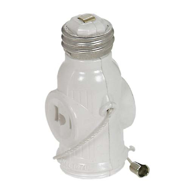

Edison base socket of any kind with a two wire (probably polarized) receptacle screwed into it.
Would have to be GFCI protected at least. :)
I don't know if they are still being manufactured, but they are definitely still on hardware store shelves.
JFLOAT
The one you screw into a porcelain with recep on side and socket on end for bulb
Had a maintenance foreman want to use in a maintenance tunnel to plug tools into.

You can even get them with pull chains switching just the socket so that you can leave the porcelain turned on.
For fixtures other than porcelains, they may still fit but I would be even more reluctant to use it that way.

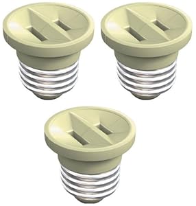

Do you mean one of these?
If your tool is double insulated and does not require an EGC it would work but if you need GFCI protection that's another issue.
Legal and code compliant are different.
I say no you can not use them.
406.4 General Installation Requirements.
Violate at least (A) (B) (C).
I counter with that it's not a receptacle any more than the two slot end of an extension cord. It's an adapter. The 'receptacle' end of a cord does not have to follow 406.4 and neither does an adapter. IMHO.

FWIW, the current versions of these adapters are polarized and assume that the socket shell is the grounded side.
They turn a relatively small safety concern into a larger one if the socket is miswired.
I think you would have to claim it was "installed" first given that these requirements are found in the installation requirements paragraph.
I don't see how something like this can be considered "installed" anymore than a light bulb is "installed".

Receptacle. A receptacle is a contact device installed at the
outlet for the connection of an attachment plug
. A single
receptacle is a single contact device with no other contact
device on the same yoke. A multiple receptacle is two or
more contact devices on the same yoke.
Call it an adapter or call it whatever it meets the definition of a receptacle to me.
