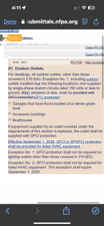

If it’s considered a seperate building or structure why wouldn’t you consider it to fall under the scope 210.8(f)’s requirement to protect these outlets located in accessory building on the dwellings property. He said its the size of a smaller detached shed.
Because (F) is for outdoor outlets. If it is considered to be indoors in a dwelling accessory structure (A) is what would apply to it, and (A) only applies to receptacle outlets which would not apply if the sauna were hard wired connection. Sauna is not mentioned in the list of specific appliances of (D) either.
It says (f) requires gfci protection for all outdoor outlets other than those covered in 210.8(a), exception 1, including outlets installed in the following locations and I circled those following locations . They say all outlets other than the receptacle outlets covered by 210.8(a) . A Hardwired outlet is not a receptacle outlet so (a) does not cover it so it falls under (f)

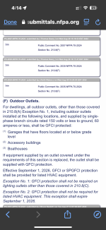

The word "in" was not the correct word as the section is only intended to apply to outside outlets. "In" will be replaced with "at" in the 2026 code to clear up the confusion.
Very good point , which would lead to an outlet located inside the barrel sauna whether it was considered to be an accessory building or not , would not fall under the scope of 210.8(f) correct ?
Btw my state deleted 210.8(f) as well so providing gfci protection for that sauna or any other outdoor hardwired utilization equipment unless required by 210.8(d) would never cross my mind either lol
I had the air conditioner units on my mind as that was one the biggest problematic things with this requirement, but did know it included all outside outlets other than the mentioned lighting outlets in the wording and/or exception but for some reason did not think about interior of dwelling accessory buildings/structures though I'm sure I was aware of it applying there at one time, just haven't been required to do so yet.
Are you talking about "in" accessory buildings? changing to "at" accessory buildings - meaning on the exterior?
It looks like they plan on incorporating sp gfci protection for listed hvac equipment once the tia expires and seeing either class A or SP GFCI protection as acceptable . I wonder if there are conditions as to which one will be acceptable based on the load pf the equipment may Don can provide clarity
