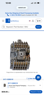

Your original contactor had a 110-277 volt coil. It would not work off of low voltage DC.
The original contactor closed when the black wire was energized 120V and opened when the red wire was energized 120V.
You connected the black and red to the new coil. These wires will never have 120V between them unless you made other modifications.
Check voltage between black and white the red and white.
I did not modify it. I took what I believed to be 24vdc control wires from the relay and connected them to a1-a2.
Found a picture of one that closely resembles yours, just can’t see the coil terminals on your picture, the side contacts appear to be auxiliary contacts. Couldn’t blow the picture up enough to make them out.
It’s either melted from the wrong voltage applied, or defective from the factory. The white bar should easily push in, and return out on its own. It is made to attach auxiliary contacts to, and activate those contacts when the coil is energized. Can you get a better picture of the contact block on the bottom? That should be the coil. Where the red and black wires are now, are power terminal screws for providing power to the control circuit off the line side. I will see if I can get a 360 picture of that contactor to be sure.
The white bar pushes in and retracts fine, it just didn’t close the contactor.
It does have 1 set of NO and NC auxiliary contacts on the bottom. Not using them.
It is possible the contactor mechanism is not assembled correctly. Either the coils is jamming something or the AUX contactor module on the side of the contactor is sticking. You should be able to push it in.
I see nothing in any picture that is provides or is powered by DC. most readily available information on relays is their contact ratings, but you need to find the coil rating.
That is exactly what I can’t find. I’m now on minute 35 on hold to ABB
Looks like the Siemens version.
GE also puts their name on them. Home Depot used them on their landscape supplies stores, as well as Publix uses the electrically held version for the emergency lighting. They can easily be changed from N/O to N/C by flipping the contact block. I think Square D has the only other one that is field convertible. But is a little more involved.
