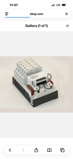

rather hard to tell if your system will work for the contactor. what is the activated voltage for the coil? do you have that voltage in the cabinet available to go through the timer contacts? cant really tell what is going on with the red and black wires connected to the contactor coil.
New contactor looks to be electrically held, only the relay can be deleted, and power straight off the time clock. Unlike the old contactor, the coil is not dual voltage, and it appears you are tapping 208 for the controls. Look on the side or between the coil terminals to check its voltage. If it is a dc coil, it will not work also.
Hard to tell from the picture, it looks like you have a black wire on one side of the coil, and nothing on the other. If the black and red wires lugged under the line side go to the relay, that is part of the problem.

You are correct, a mechanically held contactor rarely ever needs a pulse, although it can be controlled by one.
The original contactor shows a black and white wire for the close control, and a red and white wire for the open. This was probably a 120V circuit.
You new contactor shows a black and red wire for the coil.

If you push in the center "bump" in your new contactor you should be able to move it's mechanism. If the coil has "melted" it may be pinching the mechanism and keeping it from moving.
Most likely the wrong coil voltage, existing voltage applied, letting out the magic smoke.

Out of timer is the two switch legs, standard, and a neutral, to line side of relay. Load side of relay is black and red. 12” away, someone extended the red wire with A piece of black, and the black with a piece of red. Why I don’t know.
The output of this relay is shown as 30VDC. Red and black land on A1 and A2 of new contactor.

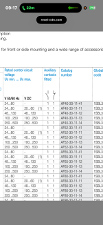

New contactor is an ABB AF-52-30-11-13. My supplier found it for me, based on needing a 3 phase contactor for 208Y, at minimum 75 Amps, as that is what was there before. Box says 100-250VAC. Worthless papers shipped in the box show short circuit rating for 480 and 600 volts.
I cannot seem to find any info on what the required input voltage on the control circuit is. When I called them yesterday at 1:00 in the afternoon, they were already closed. 😡
I did find one website where it said input voltage on the control circuit is 20-60VDC, and 24-60VAC. I usually just run the control wires from the Intermatic direct to the A1 and A2, but I can’t seem to confirm this is what this contactor can handle.

Yep, coil is melted! Kinda weird they are using DC. The old contactor says its coil voltage is 110-277.

Your original contactor had a 110-277 volt coil. It would not work off of low voltage DC.
The original contactor closed when the black wire was energized 120V and opened when the red wire was energized 120V.
You connected the black and red to the new coil. These wires will never have 120V between them unless you made other modifications.

It’s either melted from the wrong voltage applied, or defective from the factory. The white bar should easily push in, and return out on its own. It is made to attach auxiliary contacts to, and activate those contacts when the coil is energized. Can you get a better picture of the contact block on the bottom? That should be the coil. Where the red and black wires are now, are power terminal screws for providing power to the control circuit off the line side. I will see if I can get a 360 picture of that contactor to be sure.
