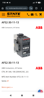

So Why Doesn’t My Contactor Work?

As others have noted the Russelectric RCS-753 Bulletin RCS was a 3 wire control the ABB one is a two wire control, for the two wire contol you simply need to provide 120V from the time clock to the coils of the ABB, omit the ice cube that was generating the 3 wire, and go from the 120V time clock to the coil. you might consider adding a snubber.
It looks like the coil is missing, if I’m not mistaken, the coil voltage appears in that window between the terminals.
Found a 360 view online, didn’t see a coil voltage anywhere. I wouldn’t think they would ship without a coil, but GE does ship the Spectra breakers without a rating plug, and since ABB is part of GE now, I wouldn’t doubt it! LOL!
Hour and a half later I finally get someone from tech support from ABB, and he can’t find info on coil voltage. 😡😡🙄
Says he’s finding both 24-60v and 100-250.
Has to look it up and email me. My money is on it being line voltage, and I need to eliminate the ice cube control relay.

I am pretty sure that ABB line are universal voltage coils, it looked from your photo you had 'On' and 'Off' from the old 3-wire control going to the new ABB coil. Verify the time clock is 120V and go from it to the coil.
post some photos of the Russel unit you removed, but I think those are 120-277 control voltage, and the ice cube, I suspect its a 120V coil controlled by the 120V intermatic time clock using NO and NC to generate ON and OFF for the Russel unit. Perhaps also there is or was a photo eye hard to guess form here.
is it not a problem that the original switch was pulse on or off (with intermatic controlling that) but now using a standard contactor that needs a constant coil voltage? seems like you need a new timer control that feeds On 120v signal during night and Off no 120v during day.
From the looks of that intermatic timer clock I'd wage thats exactly what that does, The ICE cube relay was probably switching the neutral hence only 4 wires to the relay.
