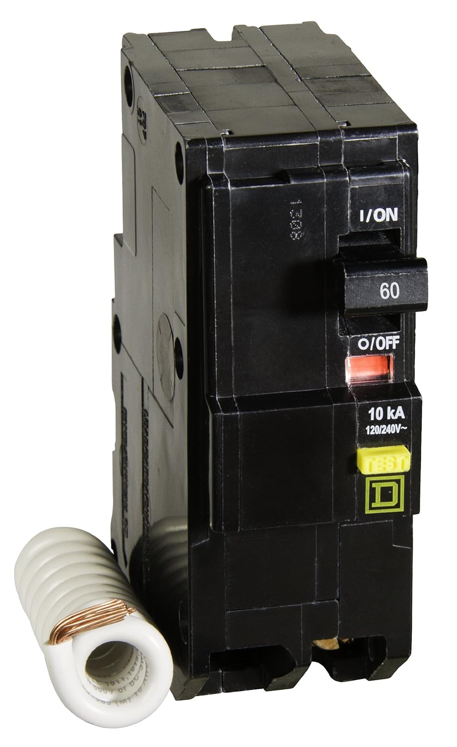

I don't understand -- you have to have a place to add a disconnect by the spa. Install a home depot box there. otherwise and a small sub panel from the main and put a gfci there.
BTW-- is this the sq.d homeline? Because sq.d does make a dp 60 gfci
https://www.amazon.com/Square-Schneider-Electric-QO260GFICP-Two-Pole/dp/B00DW474GE
Information given on that Amazon page doesn't correspond to what Square D has in their catalogs for same product number.
According to their catalog the QO260GFI is only for 2 wire loads and contains no neutral connections. The image about has to be edited as well. They have no 60 amp three wire GFCI device, yet Amazon apparently does have one:(
It can't be an EPD class device either because those also only are two wire in the 60 amp version according to Square D catalog.
The image about has to be edited as well. They have no 60 amp three wire GFCI device, yet Amazon apparently does have one:( .
Doesn't look edited to me ....: the QO260GFI still has a neutral pigtail, just no provisions for connecting a neutral to the breaker.
Can't say I have ever used one, but kind of makes some sense since less components are needed to be stocked for assembly- as in they probably use the same 120 volt logic components as they do in other GFCI breakers, this would mean you do need a supply neutral even though there is no load neutral for it to work correctly though.
