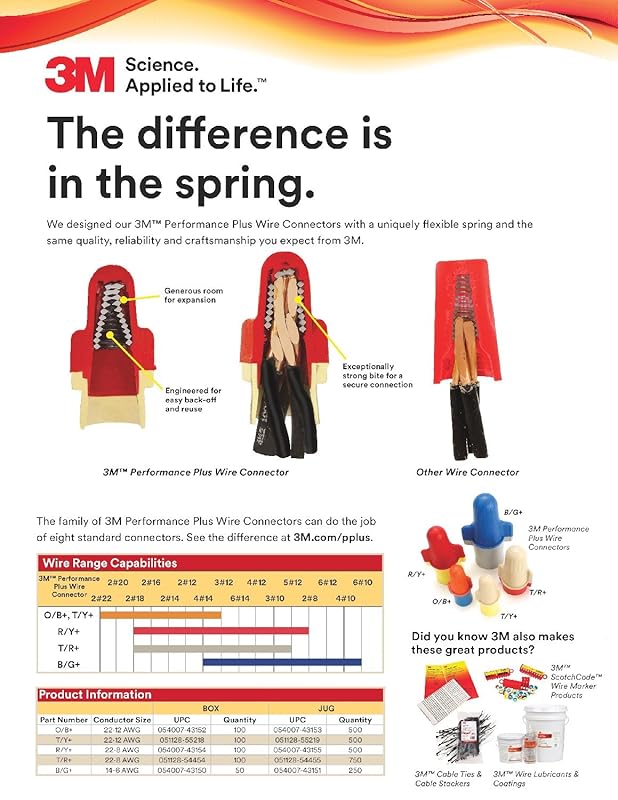

That's not how I read it.
They are good for up to six 2.5mm metric conductors. Only three #10AWG. It's not easy to decipher. 3M could have done a better job with their instructions.
Was wondering if I was the only one having trouble understanding the conductor combinations
While I agree that the metric cross-section chart seems to contradict the assertion, their matrix clearly shows you can connect up to three #10 (sol or str) with up to three #10 (sol or str) for a total of six #10 conductors.
Here's a 3M graphic that includes a Wire Range Capabilities chart that's easier to interpret. Note that the B/G+ are listed from a minimum of four #14, up to a maximum of six #10:
