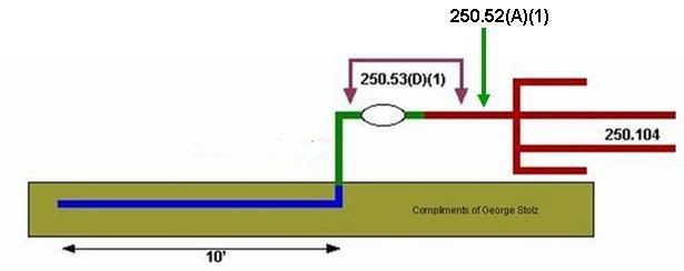

Electrode
The water pipe is only an electrode when it meets ALL the criteria of 250-52(A)(1) and if it does it must also be supplemented as per 250-53(D).
Bonding of Piping Systems and Exposed Structural Steel
The water must be bonded as per 250-104(A) and this bond is sized from table 250-66. This bond can connect anywhere accessible and 5' has nothing to do with this water pipe bond.
These are two different items, they can only be used like one when the electrode is "qualified" and the GEC is sized at 250-66 and connected not more than 5' from the point of entrance in the building.
I think you can connect to it more than 5' outside the building, as long as the pipe remains an electrode, but if it is also the water bond it shall be accessible.
The OP was asking if they can bond anywhere accessible and yes you can bond the water pipe anywhere accessible.
