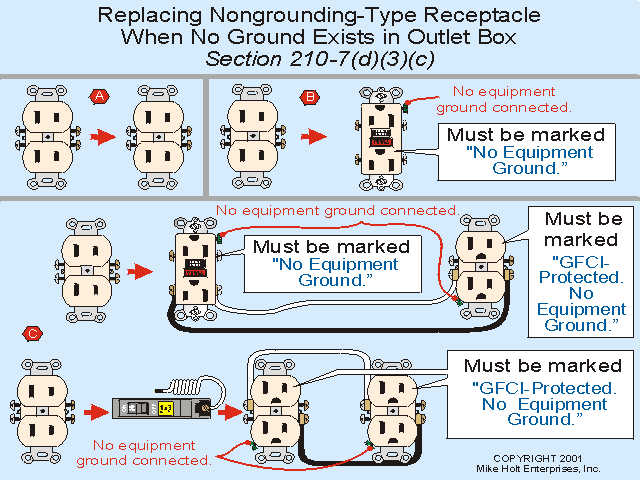

  • What codes apply when replacing old non-grounding receptacles in an existing structure?
Device replacement of the receptacles themselves are covered in 406.3(D). Some more flexible rules for installing an EGC in an existing structure are given in 250.130(C).
Please note that the goal when using one of these alternate methods is to ensure that an effective ground-fault-current path is provided. Care should be taken to be absolutely sure that the electrode connected to is in fact connected to the neutral of the service of the building served. The earth is of no consequence to a receptacle, a normally non-current-carrying solid connection back to the electrical source is what we desire.
