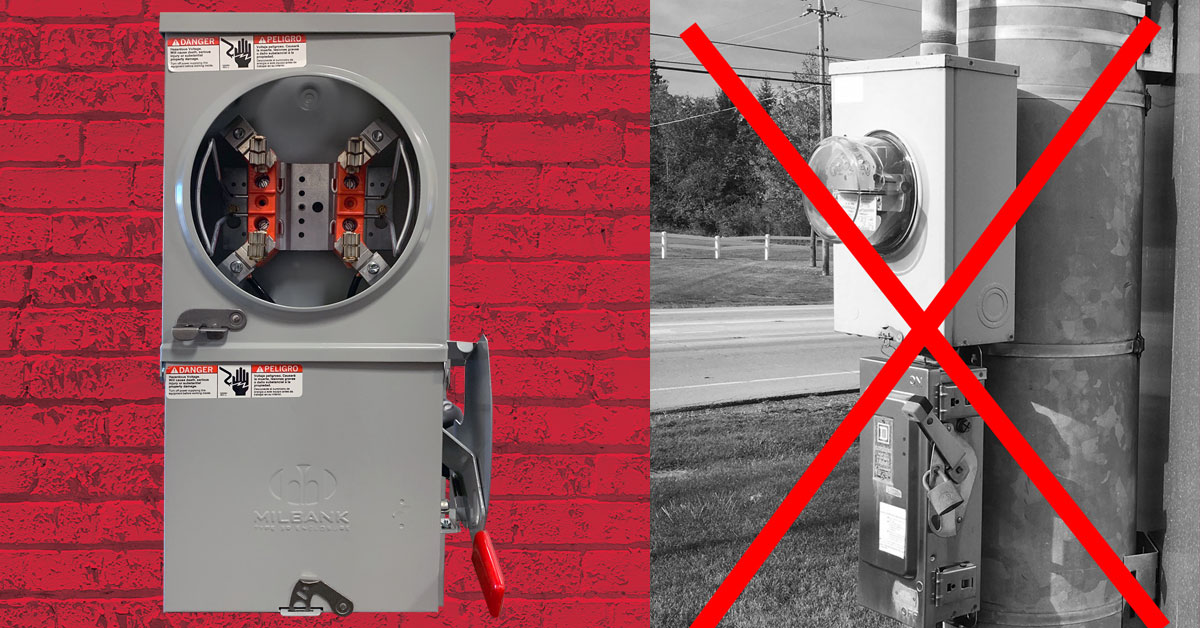

OK, you guys are really getting caught up on what qualifies as an emergency disconnect and how things are wired.
I have no questions about that. I only mentioned those things to explain WHY I was asking my question.
I am looking for a meter socket that has a safety switch or other non-overcurrent device that will serve as the emergency disconnect. Has anybody seen something like that?

Since the rule requires the emergency disconnect to be listed as "suitable for use as service equipment", I doubt you will find a non-fusible disconnect so marked. Same would apply to a molded case switch in an enclosure.

Why non-overcurrent? Any meter main will work.

The point is that you don't need that. You can use one with an overcurrent device, slap the proper label on it, and treat that OCPD as if it were only a switch.

I just want a meter socket with a safety switch or other non-overcurrent device that will serve as the emergency disconnect. Anything other than a link to a product, a description of a product with a brand name, etc is irrelevant.
I am not sure such a thing exists. If it did I assume it would be more expensive than a standard meter main because it is much less common.

Here's one in 60 amps:
My limited googling didn't turn up anything similar for 100A or 200A. For 100A, you could always do something like using a Square D C4L200S (200A bus) with a QO2000 (100A switch only) on the bus. Not sure if a similar option exists for 200A.
But I'm unclear why you insist on eliminating the outdoor OCPD? There's no upside.

If you specifically will only consider an external unfused disconnect device, I think this would qualify:
However I think you are making things unnecessarily difficult on yourself.
In post 7 you state "I'm looking for a solution where the meter has a safety switch for firefighters, but it's not a main breaker." You want something outside that acts as a switch, and something inside that is considered the main breaker, in the enclosure where you will land your GECs with only a 3 wire feed from outside to inside.
The reason that we are getting caught up on the nuance of 'what is a service disconnect' and 'what is an emergency disconnect' is that if you have an appropriate piece of equipment with an appropriate label, even if it has OCPD it is still not the main breaker. In other words with the appropriate label that outside OCPD magically becomes just a switch.
Outside OCPD might be undesirable from a coordination point of view (did my main trip or did my emergency disconnect trip), and presumably an outdoor OCPD would be less reliable than a pure switch, so I can see why you would want to avoid that. But if your goal is simple the least expensive code compliant installation I think a 'emergency disconnect only' meter main is the way to go.

While that would work for compliance with 230.85, it may not work for your utility. Ours will not permit a disconnect on the line side of their cash register, unless they specifically require a cold sequence meter disconnect. The only cold sequence meter disconnects required around here are for self contained 480 volt meters, and those are not commonly used for one and two family dwelling units.
