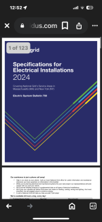

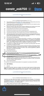

It still meets the more restrictive of the definitions in that it is still "readily Accessible" that is using a key in this picture. so nothing being shown is a violation to land the GEC within the meter.
I have never seen a requirement by national grid that it be landed in the meter but perhaps I have been doing it wrong now I'll ask my boss to check.
Don't see a requirement in National Grid ESB 750 that say you must bond the NG in the meter only that the service equipment shall be bonded in 6.2 of ESB 750. at any location approved by the NEC

I’ll admit I was wrong about one of the utilities, NAT GRID prohibits a gec connecting to the meter socket enclosure,

This I just downloaded from Eversource. "Western, Ma." Booklet.
"E. Grounding 1. The requirements of the code will be followed relative to grounding at a meter installation, specifically; • The grounding electrode conductor connection shall be made at an accessible location in the service equipment and not in the meter socket. The grounding electrode conductor shall not be run through the meter socket.
And this is from Eastern, MA which does not seem to prohibit this or I couldn't find it.
"511. Bonding Service Equipment Secondary Services: All secondary services having a grounded neutral shall have that neutral adequately grounded on the customer’s premises at the service equipment. The system grounding conductor shall be connected to the neutral conductor. The system-grounding conductor shall provide an effective ground as required by the Massachusetts Electrical Code"
"And this is from Eversource Connecticut.
Grounding 635 . The grounding electrode conductor shall be at an accessible location in the service equipment and not run through the meter socket nor the IT compartment . 636 . The Customer service entrance installation shall have a neutral which is grounded at the first point of disconnect . Meter sockets are not considered a disconnect device . • Cold sequenced metering • The first point of disconnect shall have a location to connect the neutral that is bonded to ground . • All subsequent metering equipment shall have an isolated neutral . • In instances when a neutral isolation kit is required, the isolation kit shall be from the same meter equipment manufacturer . • Hot sequenced metering • The meter socket enclosure must be bonded to the neutral position . 637 . Copper and aluminum shall never be in physical contact with each other . Use special devices designed for this purpose where electrical connection is necessary . 638 . The meter socket shall never be used as a grounding point
