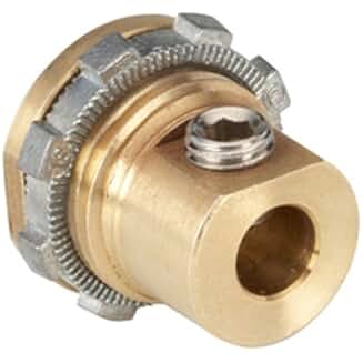

This is a great thread. What if, instead of a $10 Kenny clamp, one were to install a simple $.25 1/2" pvc connector only. Would that be a violation? What if a small section of pvc were connected to the connector to create a sleeve for the GEC to enter the panel?

So, here are the code issues (from Kenny)>>>
250.4(A)(1) Electrical systems that are grounded shall be connected to earth in a manner that will limited the voltage imposed by lightning, line surges, or unintentional contact with higher-voltage lines and that will stabilize the voltage to the earth during normal operation. ( Listed Fittings will limit sideflash NFPA 780 Lightning Protection)
• 250.8 Connection of Grounding and Bonding Equipment Grounding and bonding conductors are required to be installed with a listed fitting.
• 250.64(B) Securing and Protection from Physical Damage
Provides proper strain relief required by the UL/ANSI Standards
UL 467 Grounding and Bonding and UL 486A for Connectors, see
Annex A, NEC.
• 250.64(E) Enclosures for Grounding Electrode Conductors
Using a rigid coupling and a Kenny clamp®, one can bond both ends of a raceway without bending the conductor through a lug connected to a bond bushing.
• 300.15 Boxes, Conduit Bodies, or Fittings – Where Required Fittings and conductors shall be used for the specific wiring method for which they are designed.
• 312.5(A) Openings to Be Closed. Openings through which conductors enter cabinets, cutout boxes and meter enclosures shall be adequately closed.

250.64(E) addresses (main passage)>>> Ferrous metal raceways and enclosures <<<<
an 'enclosure' can be meter, panel, troff, JB, etc
Mike Holt himself portrays this in his literature>

Mike Holt drawings often (maybe even always) show some sort of fitting where a GEC enters such enclosures. You any find any of his literature that says there must be such a fitting there?
Straps on the raceways leaving the bottom of enclosures in the drawing you posted may or may not be needed but they drew them in anyway - but that is not what the focus of that drawing is all about either.
NEC doesn't require us to use a product that only is made by one manufacturer either. I believe that is why you sometimes see a new code requirement that involves a specific product to have a date placed in code as to when it goes into effect - to give time for others to get a product on the market. Is there other companies making a similar product as Kenny clamp or are they the only ones and need to give us reasons why their product is worth using by exaggerating what code says to some extent?

There is the GEC entry, and the GEC termination
the codes addresses the 'entry' as 'listed fitting' in 250.8
~CS~
Please cite this more specifically so I can see the exact wording as it applies to entering a 1/4" KO of a thin-walled enclosure.
from 250.64(E)(1)
shall be bonded at each end of the raceway or enclosure to the
grounding electrode or grounding electrode conductor to
create an electrically parallel path.
