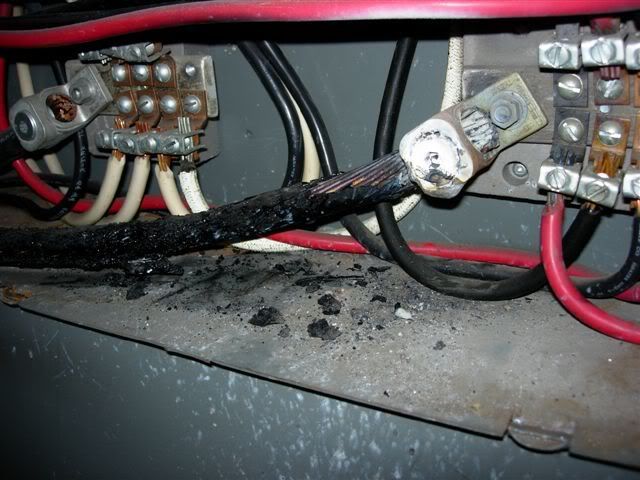

The last time I saw an apartment with one leg out the cause was
For me, this is why proper PPE is essential: you never know what's behind the cover until you open it.
(What) is that? where do the conductors fed by the burned up feeder go?
That, i am quite sure would be the neutral connection. Coming from the meter i would presume.
