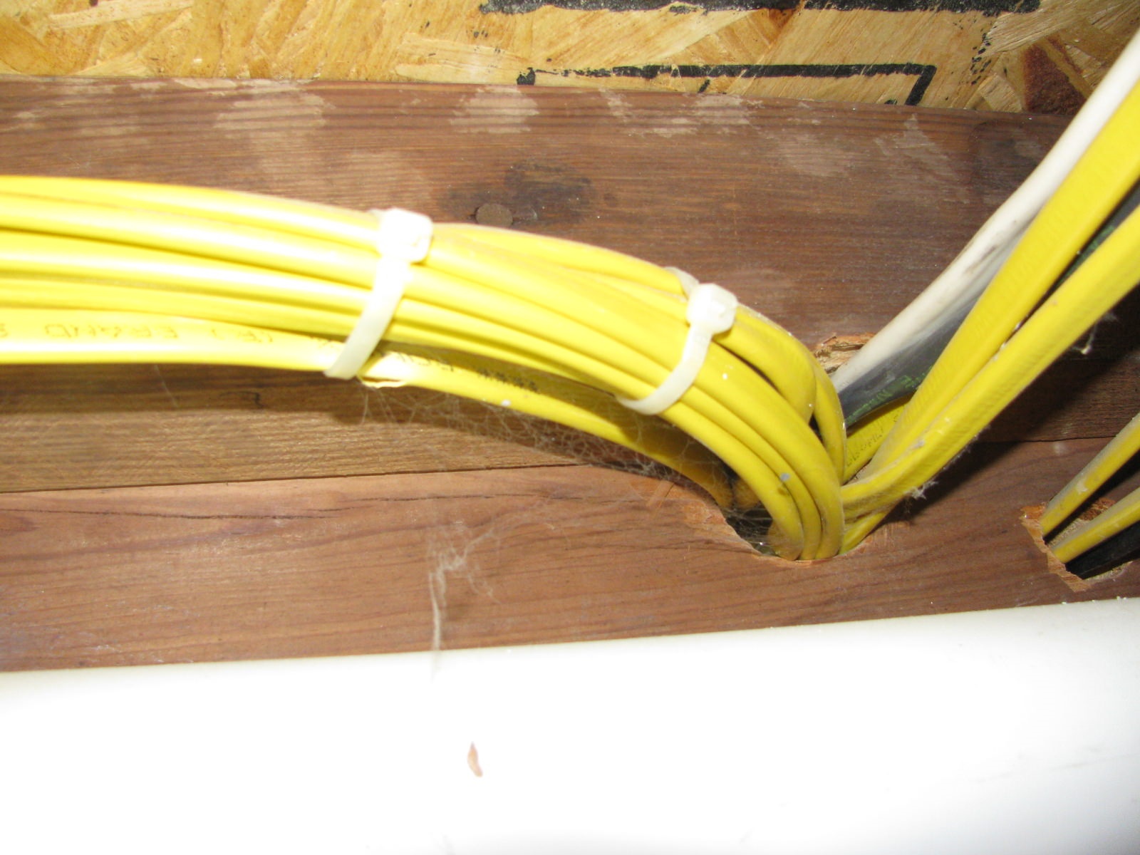

If NM is rated at 17 amps 60*C, then a 20amp device would technically be violating the intent of this rule even though it applies to larger conductors.
NM would do fine at 75*C, however I think its reasons like this that put it at the 60*C column:
http://www.inspectorsjournal.com/forum/uploads/ahis/20091221154745_047.JPG
http://images1.cableorganizer.com/a...bleway-support-system/images/10_install-4.jpg
http://s15.photobucket.com/user/TonyPE/media/P1010987_edited-1.jpg.html
http://www.doityourself.com/forum/a...led-too-tight-through-joist-subfloor-back.jpg
I frequently see NM abused like this.
But I still ask a similar question. Canada does not restrict NM to 60*C (in fact you could use 90*C if terminals let you), and 240.4D type rules do not apply to some fixed loads. Perhaps NM is bundled as much up North?
240.4 (B) May offer some incite behind 240.4(D) and the reduction in ampacity:
well, i have two replies:
1) if the wiring method/scheme is an issue then address the wiring method scheme.
2) the ohms per say " the bundled length" looks to be very small in those pics. have these so-called abused romex installations been tested in a way like the Vegas testing ??
the Vegas write-up, the five #12's to me sounds like two bc's with a common egc, maybe two in the 1/2" and three in the 3/4". i think the intent of this test is not bundling but more just about addressing the proposed derating just because its exposed to the sun.
