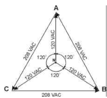

I us a CAD drawing and drew a line from 0, 120 units away on 0 deg line. Then I drew a 120 unit line from 0 on both the 120 and 240 degree lines. I extended those lines. Then I drew a circle from the 120 unit end of the 0 degree line and that circle had a radius of 240 units. Then I measured from 0 of the 120 degree line to the intersection of that line and the circle drawn earlier. That was 156.33 for both the 120 and 240 degree lines, and of course the 0 degree line did not change. The measurement between the 156.33 points of the 120 and 240 degree lines equaled 240.
What did I do wrong? What am I thinking of incorrectly?
on a 3 spoke wheel w/ 120deg between each spoke, each leg is 120 units long, but the long side is 120 sqrt-3, 208v.
Your CAD should have this correct. The Long side (ph-ph) is always ph*sqrt-3 for a 120deg 3 spoke.

We have a vector triangle of 120 V for one side and 240 V for another side, and 60 deg between these two sides. What is the length of the third side?
Break this into two right triangles. One triangle has 120 for the hypotenuse, and the other two sides are 60 ( from (sine 30) 0.5*120 ), and 103.92 ( from (cos 30) 0.866*120 ). Thus, the other right triangle is 240-60=180 for one side, and 103.92 for its second side. The hypotenuse, our desired value, is the sq-root of ( 180^2 + 103.92^2 ) = sq-root of ( 32400 + 10799 ) = 207.9 .
207.9 or 208 is not 156.
Did you just calculate the voltage for a 208Y system?

How do you get 156 V to neutral? What is your calculation?
For clarity, "Line" in this pic means the lines X,Y,Z coming off of a 208Y xfrmer? So 1-->2=208v, 1-->3=208v, and 2-->3=208v.
