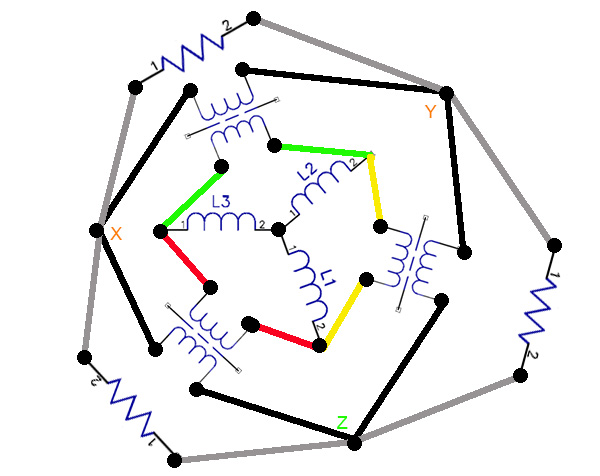

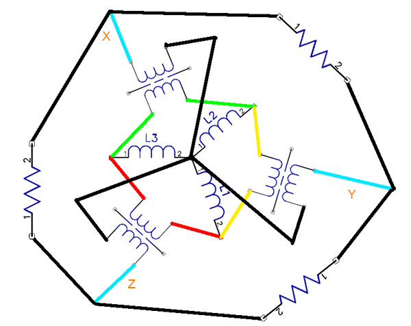

Does this work? Pros or Cons ? The xfrmers hanging on the lines are step-up's

Two or three transformers matters not a whit. One is only needing to boost the voltage line to line. Anything else is fine for a ethereal discussion of a useless magnitude of the highest degree, which is what this thread is.

FionaZuppa:
Both your circuits work, but neither is a buck or boost.
Ok, so why would I choose a BB over a L-L or L-N step-up, or vice versa?

FionaZuppa:
Think about the problem.
If the primary of your transformer is full supply voltage, and you step up to an output voltage 10% higher, and this is supplied by a separate winding, then that transformer has to have a VA capability equal to the total load.
If instead the transformer is an autotransformer, or a boost transformer, then the boost portion only has to supply the 10% higher voltage at the same current as the basic source. Thus, a boost transformer size in most appliations is much smaller than if an isolation transformer was used to do the same task. Usually boost voltage is not large compared to the source voltage.
125% of the rated input current (or next size up, if over 9A) is the MAXIMUM overcurrent protection for an autotransformer.
35A would be the largest OCPD allowed.
That is the correct percentage (125%) for a autotransformer primary protection. It was late and I didn't take time to look. Used from memory the 250% limit on isolation models, with primary and secondary protection.
