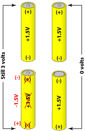

Rick Christopherson said:
I do understand your argument. You want to call these two voltage sources out of phase because that is how you (we--including myself) view them when we look at a load center, or such. This is fine, because from that particular perspective, they appear to be out of phase. This is the flexibility of being able to view circuits from a particular perspective.
However, once you draw a phasor diagram or a circuit schematic, you lose this flexibility of calling them out of phase, or even of opposite polarity--unless you also add a negative sign to the voltage?s magnitude. From a phasor diagram or circuit schematic perspective, the two voltage sources are not out of phase, and they have the same polarity.
From what I have been able to gather over the past several days, you are trying to take this perspective of the two sources being out of phase, and trying to make it an absolute in the diagram, and this is something that you cannot do (again, without adding the minus sign).
I thought of an analogy this morning on my drive to a project site. Let?s go back to the TV remote. It has 2 AA batteries connected in series with the negative terminals down and the positive terminals up, as shown to the left. The two 1.5 voltages add together to give us 3 volts total.
When we change our reference point to be at the point between those two batteries, and we use a volt meter to measure the voltages from our reference point, our volt meter will record the upper battery as having +1.5 volts, and the lower battery as having ?1.5 volts. This is shown by the Red text. So we would (could) call them out of phase (or reversed polarity).
Our point of reference has changed, but the batteries have not. This would be like crossing out the labels on the batteries an putting our own markings on it (as shown in Red Text).
You, on the other hand, are trying to redefine the battery itself and say that it is turned upside down, with its positive terminal down and the negative terminal up, and the voltage still being the positive voltage printed on the label (as shown to the right). When you add these two batteries up (i.e. connect them together) you get a total of zero volts across them.

And for those who haven't figured it out, the big blueberry is the REAL WORLD:
