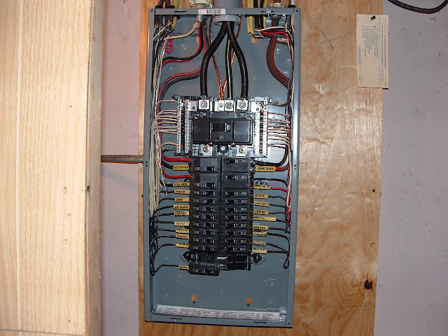

Larry, super nice work, very clean. I don't like the NM sleeves though. Were you raised that way? I am just curious, and very respectful. Have you always done that? It's just different than what I am used to seeing. Please don't think I am judging your work,...please!
Just curious:smile:
No offense taken again. :smile:
No, I haven't always done it, but when troubleshooting, it's a lot easier than having to pick up a heavy panel cover to check the breaker schedule, then count down the column to find breakers.
It's the same piece of sheath I write the circuit name on when roughing in. I cut that piece out when stripping and slide it over the ungrounded conductor, or both for 2-poles, AFCI's, and GFCI's.
Another reason: it makes it easier to tell the wire size at a glance for breaker count when heading to the store for breakers for trim-out.
Homeline? and you say you aren't a hack...LIAR!....:D
Yes, I say I'm not a hack. Not that saying it proves anthing. :cool: Actually, from what I've read, SqD and CH use the same guts in both of their lines of breakers; only the contacts and cases are different.
This house was custom designed by the owner, and he acted as his own GC. He told me I was the only trade on the job that passed any inspection on the first call, and I passed all of them first go-around.
I also did the computer networking, phone wiring, DirecTV-coax wiring, speaker/AV stuff, etc. In fact, I even laid out the entire lighting design with his input, including the hard wiring for remote/automation.

Why the ty wraps in the first pic?
Why do you leave extra wire before terminating in the second pic? I see that alot and I always wonder why.
I to the sleeve thing too. It does come in handy. Is that lug with the gec rated for two #4?
Regardless of what we think here, nice job.
Although hard to tell, it looks like they only installed one NM cable per connector too, which is also a waste. I would have doubled them up.
Would not surprise me one bit if the inspector "allowed" only one cable per connector .
I see that every now and then too, I'm not a fan of the technique, but this example is cleaner than most. The reason I heard when I asked the fellow doing that way here was it was to add a little wire for changing the panel out, or to make up for mistakes/changes inside the panel. I don't find it worth the time, and am not fond of the look, IMO.
I run my conductors to the screws farther from the cable entrance to the panel to help with that. For example, cables from the topside of the panel land on the bottom of the neutral bar.

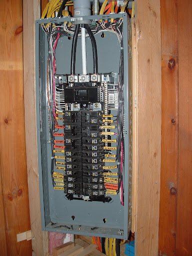

My turn, even though I said I wouldn't. Here's the latest one.
a temp I did.
Wasn't this the one we saw a little while back for a temporary outdoor event? Whatever it was for, it sure darn well is nice work:wink: I really like seeing people take that pride in their work, that's a nice job GT.
you're right, I forgot I posted that. oops
You do nice work, but I wish I could stick a tape measure over that panel and see how far the farthest staple is. :D
