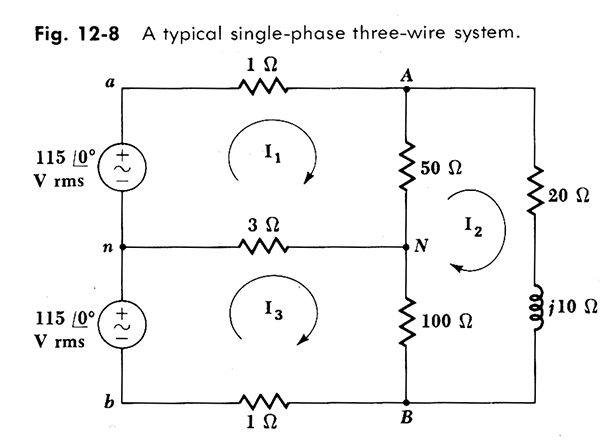

Rick Christopherson
To make this distinction between an absolute value and a referenced value more clear, consider the following (using the diagram below, and ignore the inductor if you wish because it is not important to this point):
Without even doing any lengthy circuit analysis, we all know that the current flowing through the 100 ohm resistor (between points N and B) is flowing from top-to-bottom. However, we have defined I2 to be flowing clockwise, So if I asked you, "what is the current from N-to-B with respect to I2", your answer would be some negative multiple of I2.
We have defined I2 to be flowing from B-to-N, so when we calculate the actual current flowing through this resistor, the answer will be negative (with respect to I2) because the actual current is flowing opposite to what we "assumed" when we started the circuit analysis.
Conversely, by yours and Rattus' methodology, you would indicate this current as being positive, and therefore flowing from B-to-N, which opposes the actual current.
By the way, I have not solved this circuit, but I did stay at a Holiday Inn last night....Oh, wait...I meant to say that I Cheated, and looked back at the text book. For those that are curious I3 = 10.4@-21.8 and I2 = 9.39@-24.5:grin:

Her's where I'm stalled. Take a look at the attachment
Figure 1: The current is the same anywhere in the circuit i = 10<0
Figure 2: The current is the same anywhere in the circuit i = 10<0. If I had put an N mark between the two sources, the phase angle of the current doesn't change a bit.
Figure 3: Adding the "N" point and wire didn't change a thing. The current through the resistors is still i = 10<0. The current through the sources is still i = 10<0
I'm not getting the "two different ways of accounting for current"
